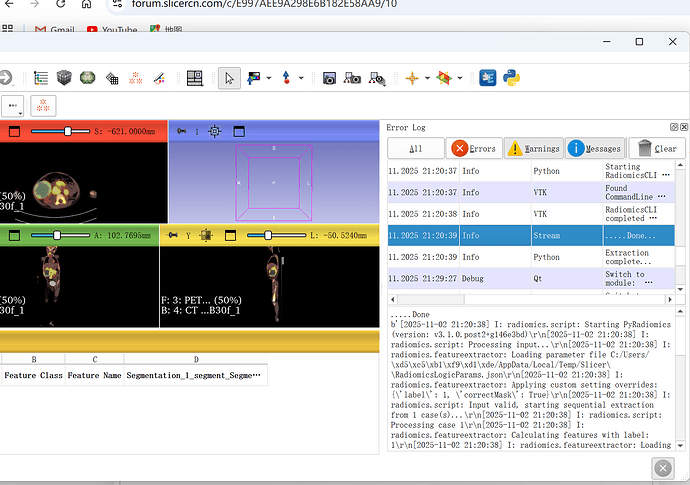

日志文件
Doneb’[2025-11-02 21:33:30] I: radiomics.script: Starting PyRadiomics (version: v3.1.0.post2+g146e3bd)\r\n[2025-11-02 21:33:30] I: radiomics.script: Processing input…\r\n[2025-11-02 21:33:30] I: radiomics.featureextractor: Loading parameter file C:/Users/\xd5\xc5\xb1\xf9\xd1\xde/AppData/Local/Temp/Slicer\RadiomicsLogicParams.json\r\n[2025-11-02 21:33:31] I: radiomics.featureextractor: Applying custom setting overrides: {‘label’: 1, ‘correctMask’: True}\r\n[2025-11-02 21:33:31] I: radiomics.script: Input valid, starting sequential extraction from 1 case(s)…\r\n[2025-11-02 21:33:31] I: radiomics.script: Processing case 1\r\n[2025-11-02 21:33:31] I: radiomics.featureextractor: Calculating features with label: 1\r\n[2025-11-02 21:33:31] I: radiomics.featureextractor: Loading image and mask\r\n[2025-11-02 21:33:31] E: radiomics.script: Feature extraction failed!\r\nTraceback (most recent call last):\r\n File “D:\Slicer 5.8.1\slicer.org\Extensions-33241\SlicerRadiomics\Lib\site-packages\radiomics\scripts\segment.py”, line 70, in _extractFeatures\r\n feature_vector.update(extractor.execute(imageFilepath, maskFilepath, label, label_channel))\r\n File “D:\Slicer 5.8.1\slicer.org\Extensions-33241\SlicerRadiomics\Lib\site-packages\radiomics\featureextractor.py”, line 272, in execute\r\n image, mask = self.loadImage(imageFilepath, maskFilepath, generalInfo, **_settings)\r\n File “D:\Slicer 5.8.1\slicer.org\Extensions-33241\SlicerRadiomics\Lib\site-packages\radiomics\featureextractor.py”, line 371, in loadImage\r\n image = sitk.ReadImage(ImageFilePath)\r\n File “D:\Slicer 5.8.1\lib\Python\Lib\site-packages\SimpleITK\extra.py”, line 384, in ReadImage\r\n return reader.Execute()\r\n File “D:\Slicer 5.8.1\lib\Python\Lib\site-packages\SimpleITK\SimpleITK.py”, line 6218, in Execute\r\n return _SimpleITK.ImageFileReader_Execute(self)\r\nRuntimeError: Exception thrown in SimpleITK ImageFileReader_Execute: C:\D\S\S-0-build\ITK\Modules\IO\NRRD\src\itkNrrdImageIO.cxx:294:\r\nitk::ERROR: NrrdImageIO(00000277880C4780): ReadImageInformation: Error reading C:/Users/\xd5\xc5\xb1\xf9\xd1\xde/AppData/Local/Temp/Slicer/CIFDC_vtkMRMLScalarVolumeNodeE.nrrd:\r\n[nrrd] nrrdLoad: fopen(“C:/Users//AppData/Local/Temp/Slicer/CIFDC_vtkMRMLScalarVolumeNodeE.nrrd”,“rb”) failed: Illegal byte sequence\r\n\r\n[2025-11-02 21:33:31] I: radiomics.script: Processing results…\r\n[2025-11-02 21:33:31] I: radiomics.script: Finished segment-based extraction successfully…\r\n’
关键点在这句报错:
fopen("C:/Users//AppData/Local/Temp/Slicer/CIFDC_vtkMRMLScalarVolumeNodeE.nrrd","rb") failed
和上面那行:
也就是说:
  • 你的 Windows 用户名是中文(张××)
  • SlicerRadiomics 在临时目录 C:/Users/张…/AppData/Local/Temp/Slicer 里写入 NRRD 文件;
  • 到 SimpleITK 读取时,路径里的中文被编码成乱码,最后变成 C:/Users//AppData/...
    NRRD 库就报了 Illegal byte sequence,导致特征提取失败。
图像导入、分割都没问题,只是 插件把数据写到临时目录后读不回来,所以计算失败。

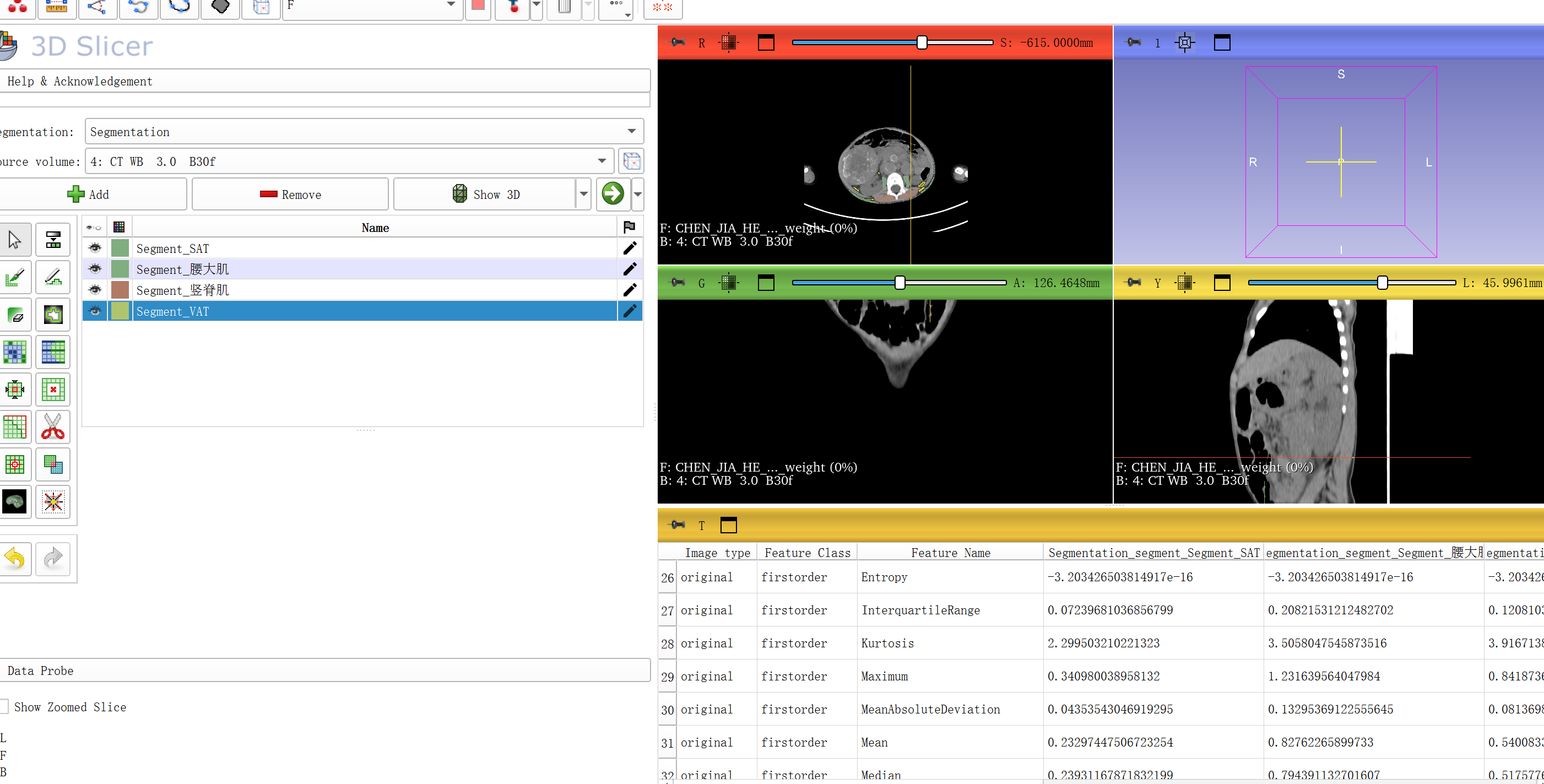

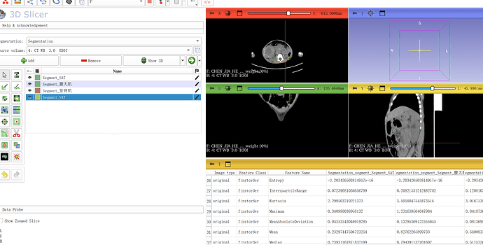

感谢老师回复,已能成功计算
